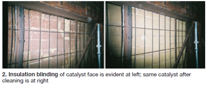

SCR catalyst systems may run with little attention for three to five years and gradually begin to show signs of performance loss and system wear. Several things can trigger a decrease in the NOx emissions control system’s ability to perform adequately. This includes HRSG tube leaks, blinding of the catalyst inlet by dislodged liner insulation, plugged ammonia injection lances, seal degradation, and/or abnormal turbine conditions (Fig 2). It is important to monitor equipment condition and evaluate performance demands against system capabilities to ensure reliable operation and avoid emergency shutdowns.

Catalyst condition should be evaluated regularly. Catalyst is the most expensive part of the SCR and its performance can vary widely over the system’s lifetime. Plants where catalyst has been operated and maintained properly typically report long life prior to replacement. Responsible planning and auditing can increase the useful lifetime, thereby effectively reducing SCR operating costs and avoiding the large, unbudgeted expenditures associated with buying new catalyst. For the most effective program, gas-plant owners should focus on the long term and evaluate SCR life-cycle costs.

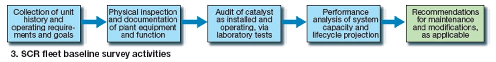

For plant owners and operators, a baseline survey of each SCR unit within the fleet serves as the logical starting point in the development of an overall catalyst management process and strategy. This fleet-wide approach leads to a comprehensive and efficient management plan that will lower costs and make decision-making more efficient. It is superior to managing various SCR systems at different plants individually.
A fleet SCR manager should be chosen. His or her job is to assure the compliance of all environmental air permitting requirements by creating a comprehensive baseline for each site and developing an ongoing, preventive maintenance strategy. Since SCR equipment is custom-manufactured for the unique demands of each plant, the fleet manager must take into account current and future permit conditions and operating demands on each unit.
Balancing the requirements of each SCR system in the fleet can be challenging. A system can reduce NOx by greater than 95%, but, when the efficiency of the SCR is pushed beyond 85% and—or, if—the outlet emissions are less than 5 ppm, the system becomes much more sensitive to several independent system parameters. These include overall catalytic potential, effective ammonia injection/mixing in the flue-gas stream, flue-gas characteristics for inlet NOx, velocity, and temperature distributions. Issues can be addressed by high-efficiency SCR designs with system modeling, flow correction devices, enhanced catalyst volumes, and a robust ammonia injection grid design.
As plant equipment is upgraded, repaired, or otherwise modified, the performance environment for reliable emissions control can be affected. Understanding these potential impacts to the SCR system is essential and should be studied. For example, components of the ammonia delivery system may deteriorate over time. The system may reach a point where it can no longer perform adequately with aging catalyst.
Baseline survey. A properly executed baseline survey, conducted by a qualified catalyst management provider, should fully assess the current condition of each SCR in the fleet. Surveys must be site-specific, since each location will have its own unique history and permitting requirements. The survey should begin with each site’s air permitting requirements and goals, which can vary significantly based on the age of the unit, geographic location, cost of ammonia, etc. And, it should identify the SCR system supplier and include a review of the site’s operating history (Fig 3).
Next, site maintenance records, catalyst test reports, and control-room feedback should be assembled. Finally, a documented physical inspection of the SCR catalyst systems is recommended to help verify the historical records and equipment status.
