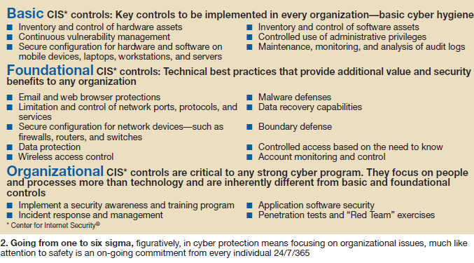

Of course, with digital transformation comes digital vulnerabilities. Cybersecurity continues to suck up more and more of the oxygen in the room. In fact, Schilling likened the cybersecurity dimensions of patch testing, the matrix of supported products, chain-of-custody compliance, device control, asset inventory control reports, and domain “trust relationships” between Ovation and customer corporate IT managers to string theory in physics. “It has 28 dimensions,” he joked.
Jaime Foose, who heads PWS’s cybersecurity and customer services group, noted that the organization now has close to 40 professionals devoted to 24/7 telephone support for customers in North America and Latin America. Delivering on a promise from the 2017 Users Group, Foose announced the availability of the “Preventive Maintenance Guide,” with example checklists for system lifecycle support, segmented by workstations, controllers, network, I/O, the Power and Water Cybersecurity Suite, and others.

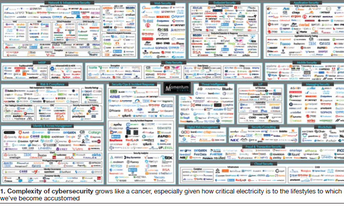

Foose added some gravity to Schilling’s 28 cybersecurity dimensions. A slide with dozens of cybersecurity firm “brands” for various protective functions (Fig 1) comes across like a work of modern art—each individual brand disappears into a chaotic blur. The underlying message? Leave it to Emerson’s cyber experts who understand both IT security and power generation, unlike pure IT firms. Plant managers may want to benchmark their cybersecurity activities to the broad levels and actions shown in Fig 2.
