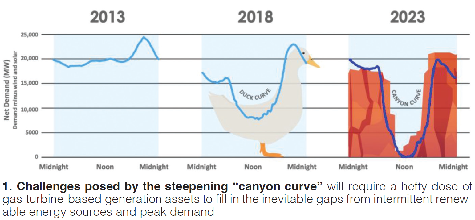

The keynote presentation by EPRI’s Bobby Noble delved into the evolving global energy landscape, highlighting the transformative role of gas turbines in the energy transition. Addressing a “perfect storm” of challenges and opportunities, Noble underscores the necessity of collaboration, innovation, and a balanced approach to achieve decarbonization goals.
The energy sector is rapidly transforming as global efforts prioritize reducing carbon emissions and adopting low-carbon technologies. Since the early 2000s, the transition from coal to cleaner fuels like natural gas and the integration of renewable energy sources have driven significant progress. By 2050, most countries aim to achieve net-zero emissions, though substantial infrastructure and technological gaps must be addressed to meet these ambitious targets.
Gas turbines are positioned as essential enablers of this transition, offering flexibility, resilience, and cost-effective solutions. Advances in low-carbon fuel technologies, such as hydrogen compatibility and carbon capture and storage (CCS) systems, enable gas turbines to complement renewable energy sources, ensuring reliability and grid stability.
Despite these innovations, challenges remain, including the developmental stage of advanced energy storage and hydrogen production technologies. Accelerating the energy transition without fully mature solutions risks reliability issues, emphasizing the importance of strategic deployment and robust infrastructure development (Fig 1).
Noble called for the electric sector to lead decarbonization efforts through global collaboration and phased integration of emerging technologies. This approach will facilitate a sustainable energy future by balancing innovation with strategic planning.

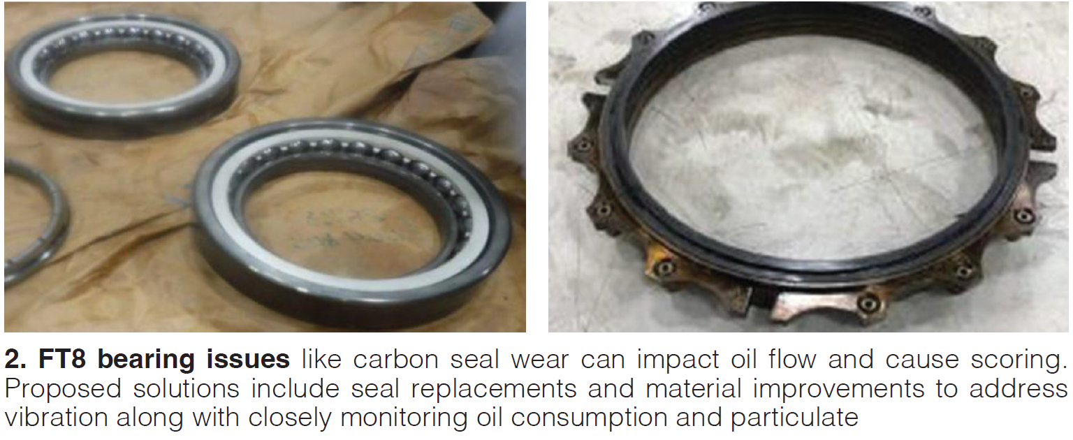

FT8 gas turbines have experienced several recurring issues over the years, particularly in bearings, compressors, combustion systems, and synchronous condensing operations. Among these, bearing failures have been a consistent concern.
Carbon oil seals and bearings often fail due to wear, leakage, and coking, which block oil flow and cause severe damage (Fig 2). Insufficient lubrication during synchronous condensing is a major contributor to catastrophic failures such as rotor lock-ups. To mitigate these issues, users were advised to replace carbon oil seals and bearings during hot section inspections and improve oil monitoring systems to detect anomalies early.

Rotor and tie-rod failures emerged as a particularly severe issue. Overheating and insufficient lubrication during synchronous condensing led to tie rod failures, rotor misalignment, and blade damage, often requiring complete overhauls. These failures highlighted the importance of adapting maintenance practices to the operational demands of modern FT8 usage.
Proactive recommendations proposed to address these challenges included:
  • Collaborate with OEM to update maintenance practices, improve material designs, and resolve component limitations.
  • Proactively replace critical components such as carbon oil seals, bearings, and gang channel rivets during inspections.

  • Monitor vibration, oil consumption, and chip detector alarms closely to detect early signs of failure.

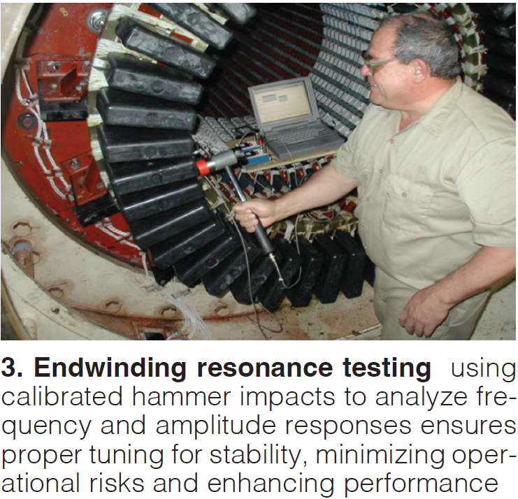

Specific electrical tests such as winding resistance (Fig 3) and insulation resistance are critical for diagnosing imbalances, contamination, or damage, while advanced methods like DC leakage tests and polarization index measurements provide deeper insights into insulation health and failure risks.
Clark expounded on the value of advanced diagnostic tools, such as the EL CID for identifying lamination shorts and end-winding resonance tests for optimizing stability. Techniques like robotic inspections, surge tests, and acoustic surveys represent evolving technologies improving reliability and detection precision.
Key takeaways include the necessity of addressing identified issues promptly through actions like cleaning, soldering, or reassembly to maintain generator integrity. Examples of good and bad test results emphasize the importance of diagnostic accuracy and corrective actions.

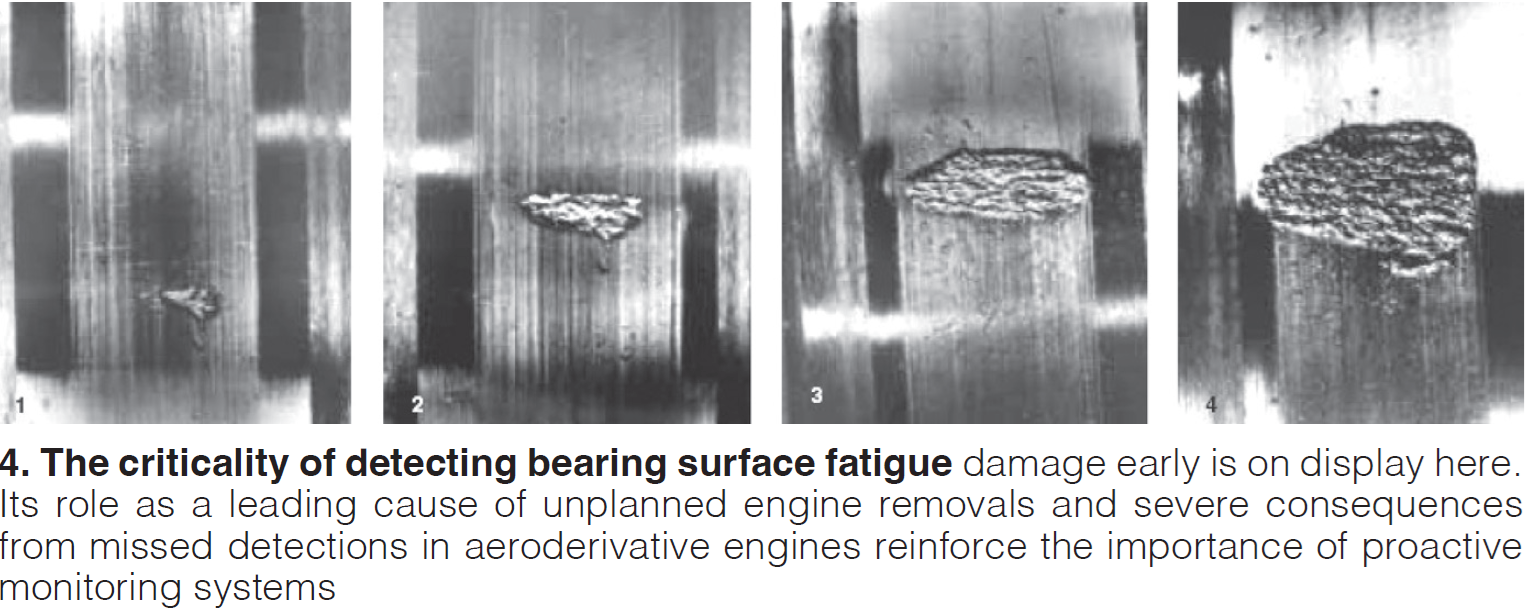

Simon Wilson and Zachary Reesor present compelling case studies on company’s renowned MetalSCAN Oil Debris Monitoring System, highlighting its innovative approach to monitoring critical rotating components. MetalSCAN addresses the limitations of traditional methods by offering 100% detection of metallic debris and precise particle classification, enabling early damage identification and risk mitigation.
Features such as real-time monitoring, remaining useful life prediction, and maintenance-free operation allow operators to plan maintenance effectively, reducing costs and downtime. Case studies illustrate MetalSCAN’s success in proactive maintenance, avoiding secondary damage, and ensuring operational continuity (Fig 4).
GasTops combines monitoring technology with laboratory services, providing detailed analysis to enhance diagnostics and decision-making. This integrated approach significantly improves equipment reliability and efficiency.

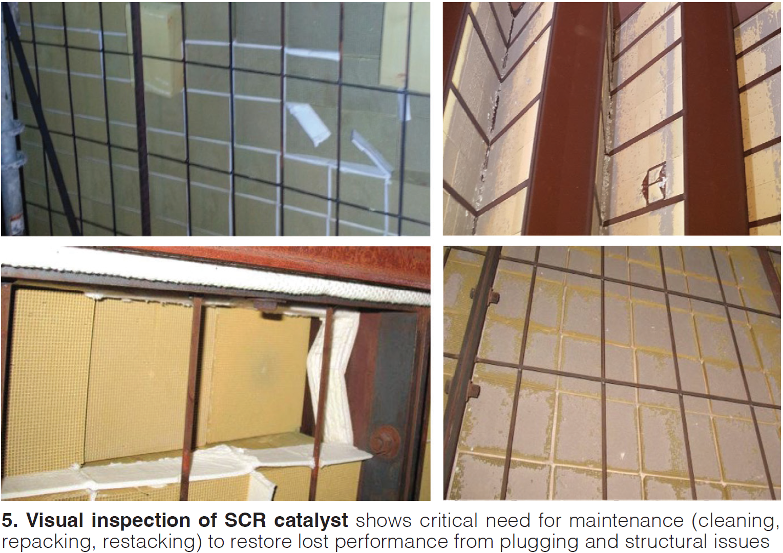

Matt Cohen, technical sales lead, emphasized catalyst cleaning and lifecycle management’s critical role in maintaining industrial system efficiency. Groome specializes in services like HRSG tube cleaning, SCR catalyst maintenance, and CO catalyst washing. Key factors impacting performance include non-uniform gas flow, temperature variations, and catalyst deterioration caused by fouling, poisoning, and structural damage (Fig 5).
Groome’s maintenance programs address these challenges through advanced cleaning techniques and system optimization. For CO catalyst systems, methods like acid washing and gasket retention improve backpressure and extend component life, while AIG cleaning and tuning ensure precise ammonia distribution to enhance SCR performance.
Cohen stresses the importance of regular catalyst testing and system analysis. Testing enables the identification of catalyst versus system problems, guiding corrective actions and preventing costly downtime. By integrating visual inspections, operating data analysis, and sample testing, Groome provides a comprehensive evaluation of system performance.
The financial impact of maintenance was shown in a case study of an ethylene plant that achieved a nine-day payback period through catalyst cleaning, significantly boosting daily revenue. Additionally, the cost of pressure drops across turbines is quantified, showcasing the economic benefits of maintaining optimal system conditions.
Ultimately, proper catalyst maintenance and lifecycle management ensures improved performance, reduced operational costs, and extended system life.

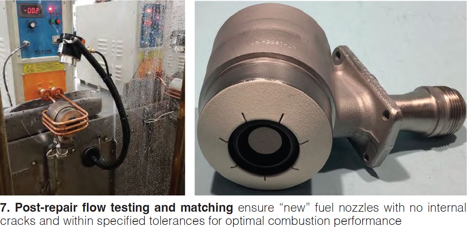

Jeff Chapin, business development manager, and former plant manager Shawn Fowler updated attendees on advanced solutions for repairing and optimizing FT8-3 dual-fuel nozzles, addressing challenges related to fuel system backflow and component failures.
Liburdi, a leading provider of turbine component repair services since 1979, supports industries like oil and gas, power generation, and aerospace with cost-effective maintenance and repair strategies.
Of great interest to end usersis the issue of liquid fuel backflow into the gas supply system, causing coking and blockages in nozzles, headers, and hoses. Testing revealed that internal stress cracks within fuel nozzles allowed cross-talk between liquid and gas flow paths, exacerbating the problem. Early indicators showed localized coking in specific nozzles, with further testing demonstrating that rebuilt nozzles often failed within short operational timeframes.
To address these issues, Liburdi developed advanced repair processes. The repair strategy includes rigorous inspections, material verification, cleaning, dimensional assessments, and application of wear-resistant coatings (Fig 7). For severely damaged nozzles, advanced techniques such as weld repair of internal housing cracks and reassembly ensure leak-free operation. This approach significantly extends nozzle life and mitigates failure risks.
Liburdi’s solutions also emphasize cost savings. Repairs typically cost 25%-30% of replacement parts, providing significant financial advantages. Root cause analysis and redesigned components further enhance reliability, reducing maintenance cycles and operational disruptions.
The presentation highlights successful implementation of new and repaired nozzles in 16 of 24 engines at one particular site, with operational tests confirming the effectiveness of these interventions. By combining technical expertise, rigorous testing, and innovative repair solutions, Liburdi supports customers in maximizing turbine efficiency, minimizing downtime, and extending component life.

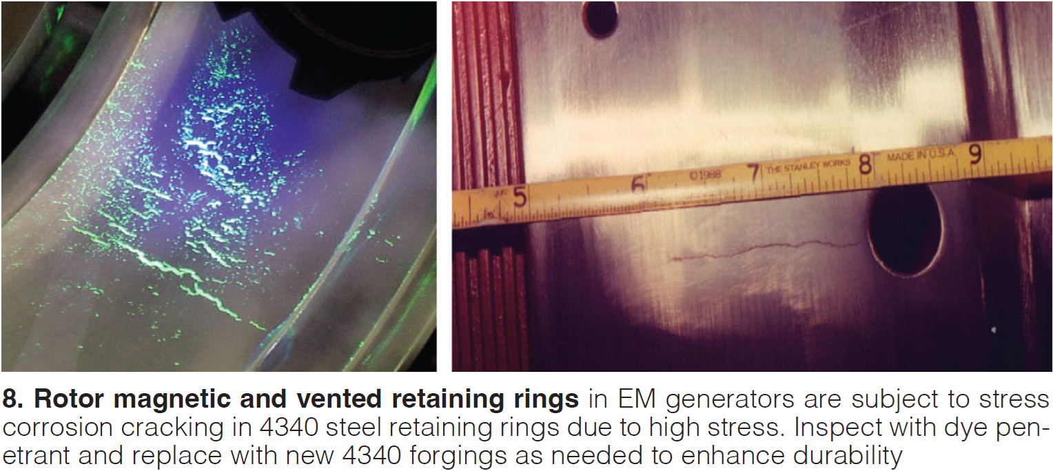

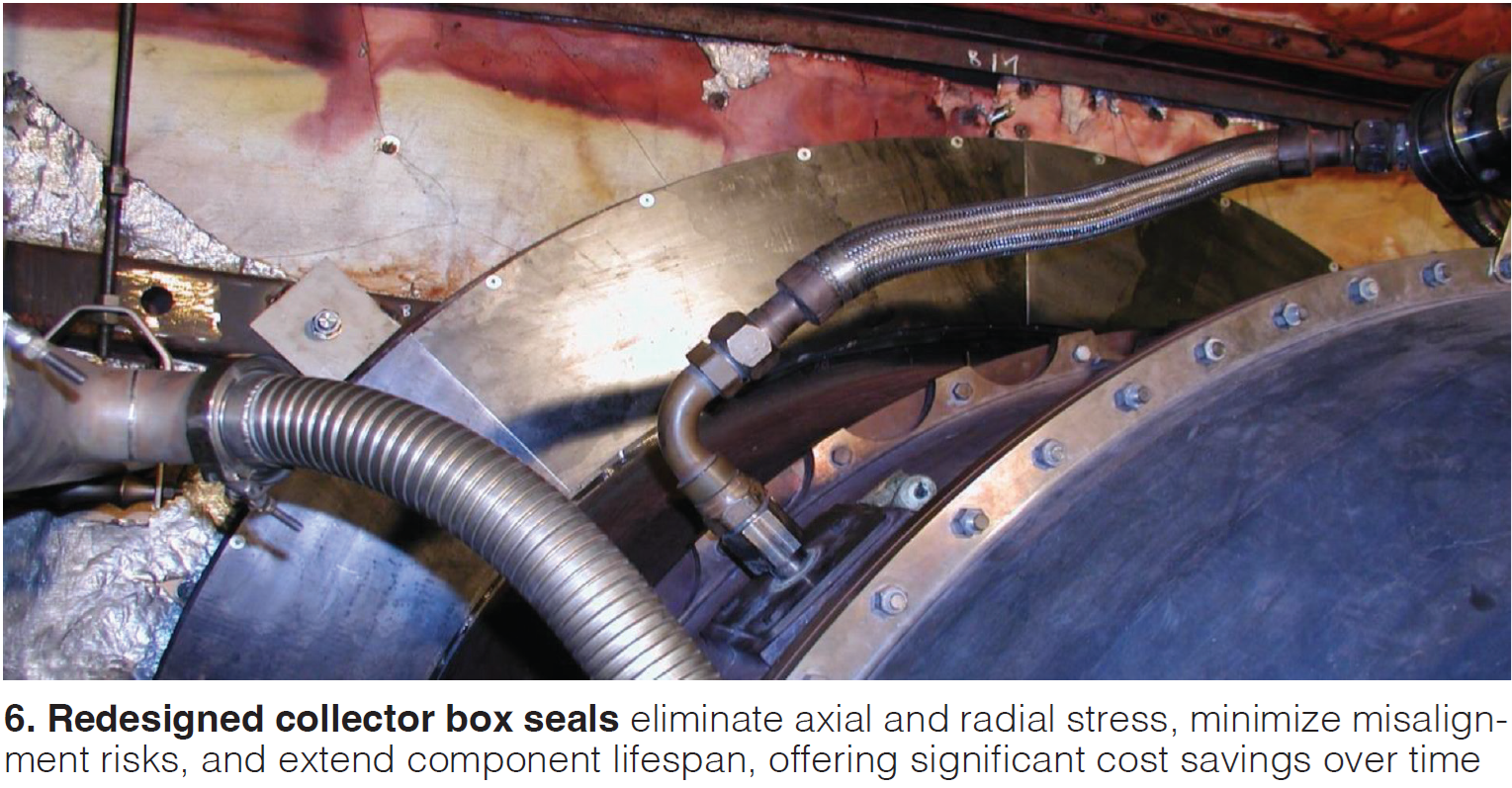

Generator guru Howard Moudy addressed critical concerns and solutions for FT8-applied generators, emphasizing contamination, partial discharge, rotor and stator maintenance, and tailored repair methodologies. As a global leader with over a century of experience in generator technology, NEC focuses on quality, performance optimization, and longevity.
Key challenges highlighted include contamination from operational environments and aging systems, leading to issues such as partial discharge, corona damage, and cooling inefficiencies. NEC employs advanced cleaning methods like CO2 cleaning to safely remove contaminants without damaging components. For partial discharge and corona concerns, NEC leverages IEEE standards and engineered solutions to mitigate damage and improve insulation longevity.
The presentation features case studies illustrating common issues and their resolutions. For example, rotor challenges such as magnetic retaining ring stress corrosion cracking (Fig 8) and tooth-top fatigue are addressed through advanced engineering solutions like replacing fabricated assemblies with solid billets and implementing new retaining ring designs.
Stator issues, such as coil damage and end-winding failures, are tackled using tailored repairs involving high-quality replacement coils, outer corona protection systems, and slot-side packing upgrades.
Through innovative approaches and proven expertise, NEC enhances generator reliability, reduces maintenance costs, and extends service life. The presentation underscores NEC’s commitment to delivering world-class solutions for generator repair, maintenance, and component manufacturing, solidifying its position as a trusted partner in the power generation industry.

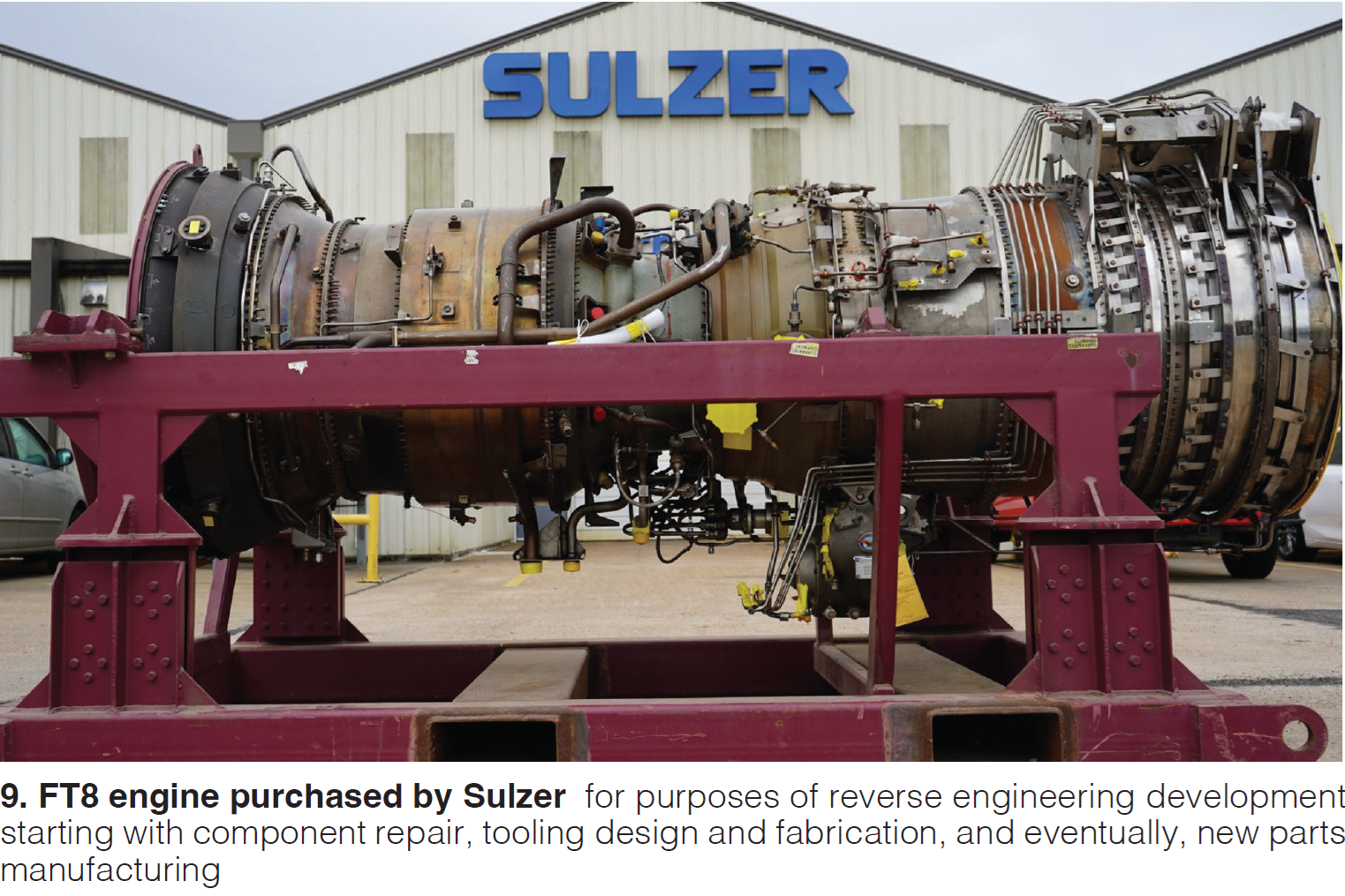

Matt Walton, gas turbine metallurgy and repair expert, highlighted the company’s ongoing efforts to provide extensive maintenance capabilities for FT8 users, including depot-level services, component repairs, and reverse engineering (Fig 9). These developments, unknown to many attendees, were met with great interest and excitement, spurring a valuable exchange of ideas, suggestions, and ambitions.
Sulzer’s field service team, with a long history of aeroderivative expertise, offers borescope inspections, module swaps, installations, commissioning, and troubleshooting. While describing this group dedicated to specialty aeroderivative field work, Walton reiterated their commitment to this market, “If you want to be in an engine, you have to be in the engine all the way.”
The company’s service roadmap includes ongoing development of reverse engineering capabilities, heat treatment validation, coating advancements, and the production of new parts like gas generator components and bearings.
A key focus is Sulzer’s ability to reduce turnaround times and costs for depot-level services. By integrating reverse engineering and precision manufacturing, Sulzer addresses issues of OEM scrap, financial inefficiencies, and delayed service delivery. Walton invited users to engage in shaping Sulzer’s offerings, highlighting a collaborative approach to better serve the FT8 community.
