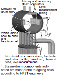

He began his presentation, available to users online, with a quick primer on steam drums, their function, and refresher illustrations, and a list of five important drum components (Fig 1). Then he identified the five issues he would speak to:
      • Steam-purity degradation.
      • Drum-level-measurement piping condition.
      • Nozzle weld cracking.
      • Shell weld cracking.
      • Manway sealing reliability.
