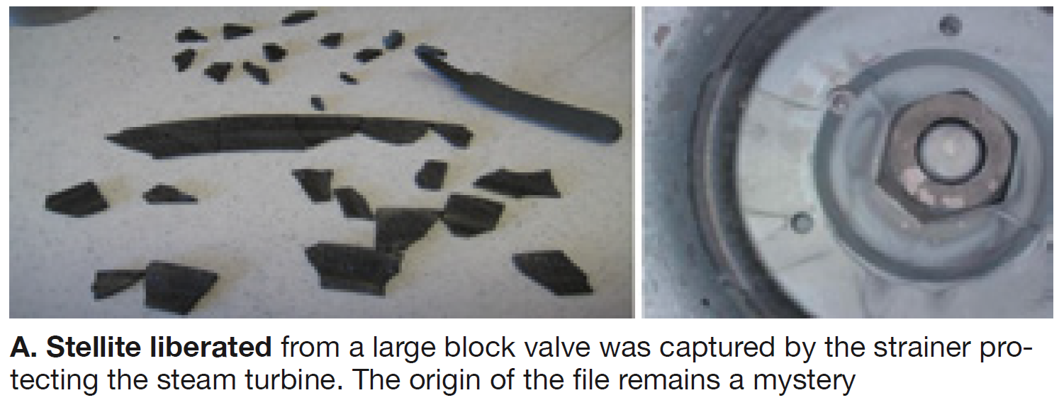

The D11 steam turbine for a 2 x 1 7FA-powered combined cycle recently experienced an increase in HP-cylinder inlet pressure as well as a slight decrease in electrical output. Design steam conditions for the HRSGs were 1450 psig/1070F at the HP outlets and 450 psig/1067F at the HRH outlets. Lifetime operating hours totaled about 45,000, starts (mostly warm) 150.
Plant personnel began their investigation by following the recommendations of the OEM’s Technical Information Letter (TIL) 1629-R1, “Combined Stop and Control Valve Seat Stellite Liberation,” released Dec 31, 2010. The inspection team found that no stellite had been liberated from the valve seat; however, multiple cracks were found in the stellite inlay (Fig 1).

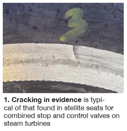

Inspection results: Disbonding of hardfacing was identified on all HP and HRH valve seats; also on the seat and guide rails of the HP non-return globe valves. The IP and CRH valves showed no disbonding. Further investigation revealed that the hardfacing for the HP and HRH valves was applied using the Plasma Transferred Arc Welding (PTAW) process and for the HP non-return globes it was the Shielded Metal Arc Welding (SMAW) process.

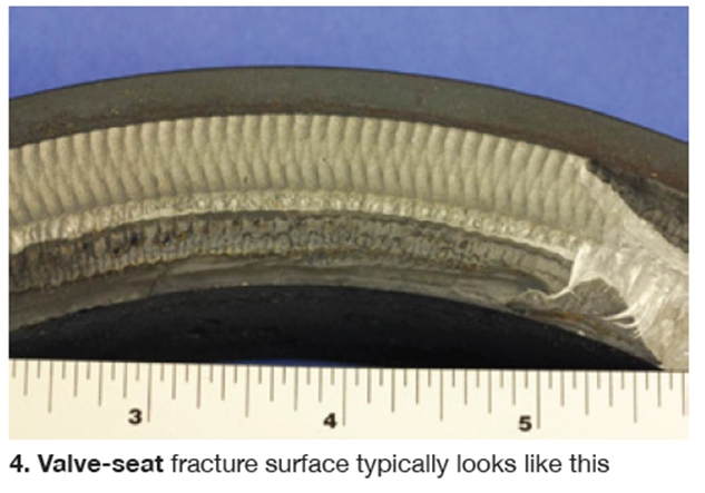

Also, hardfacing on the HP and HRH gate-valve seats and discs was of bi-layered construction: An Alloy 21 buffer layer applied to the Grade 91 seat rings and an Alloy 6 finishing layer. The former is a low-carbon CoCrMo alloy with the AWS/ASME solid-wire filler-metal designation ERCoCr-E. It is characterized by reasonable ductility and metal-to-metal wear resistance at elevated temperatures. By contrast, Alloy 6 is a high-carbon CoCrW alloy with an AWS/ASME solid-wire designation of ERCoCr-A having improved metal-to-metal wear resistance at elevated temperatures.
Evaluation of the fracture surface raised concern that the failures were located in the Grade 91 base metal and might be similar to other creep-related dissimilar-metal failures found in Grade 91 piping (Fig 4). However, examination of the Grade 91 base metal revealed a tempered martensitic structure consistent with material that had been properly heat treated.The valve manufacturer’s service technician said that prior to the millennium, Alloy 6 typically was used for hardfacing of valve seats. But multiple disbonding incidents prompted his company to adopt the bi-layered approach. The thinking was that the improved ductility of Alloy 21 would minimize the risk of disbonding while the finishing layer of Alloy 6 would maintain a high degree of metal-to-metal wear resistance. Research revealed other valve manufacturers had similar issues with disbonding and they are using Alloy 21, stainless steel, or Inconel as buffer layers.
The heat-affected zone (HAZ) created by the deposition of hardfacing, while of a normal structure for Grade 91 material, was wider than normally would be expected given the thickness of the overlay. This indicated that relatively high heat inputs were used during the PTAW application of at least the buffer layer of Alloy 21. There was no evidence of creep damage in the Grade 91 HAZ.
Cracking that contributed to the disbonding of the hardfacing from the base metal developed near the interface between the valve seat and the stellite. It was caused largely by brittle fracture that had propagated through the Alloy 21 buffer layer. In some areas, the cracking propagated very close to, or along, the dissimilar-metal interface between the Grade 91 and Alloy 21.

SIDEBAR: Valves didn’t get the respect they deserved
The editors first learned of stellite delamination in a large valve designed for high-pressure (HP)/high-temperature steam service at the 2009 7F Users Group conference. But all the attention that incident received was a brief mention late in a long user presentation profiling the major inspection of a combined-cycle plant. More than 200 owner/operators were in attendance, yet no questions were asked about the issue—at least none the editors can recall—and it was quickly dismissed. Fig A shows stellite liberated from the seat of a 20-in. hot-reheat block valve installed at that presenter’s plant and collected in the strainer for the steam turbine’s combined stop and control valve.
Another alert concerning stellite liberation came from GE Energy, which issued Technical Information Letter 1626 on Jan 30, 2009. It advised steam-turbine owners to check the condition of the stellite inlay sections used in fabricating seats for the OEM’s combined stop and control valves. Revision 1 of that TIL, dated Dec 31, 2010, recommended a “one-time seat stellite inlay UT inspection during valve installation or next planned maintenance inspection.”

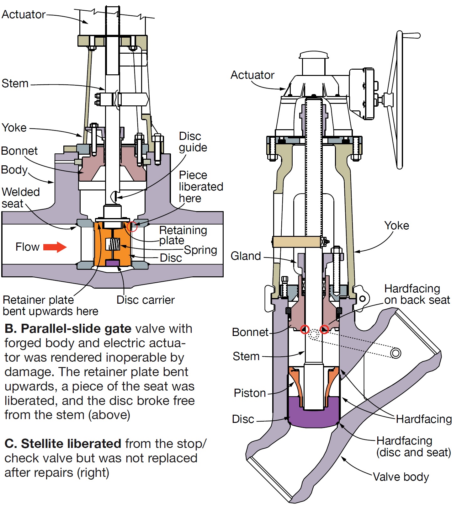

Operability issues experienced with a parallel-slide gate in HP steam service at another plant in the fleet raised a red flag and engineers inspected all four HP valves on its two HRSGs during an outage planned for 10 days. That outage was extended by about a month and half because of the valve work.
Cracking of seats and discs was found on both parallel-slide gate valves (Fig B) and both stop/checks (Fig C). Some of the liberated stellite still has not been found. All four valves were removed and send to a qualified shop for repairs.
The parallel-slide gates had serious issues. The retainer plates in both either broke or bent and contributed to body damage; pieces of stellite liberated from the seat rings on both gates. In addition, the disc came off the stem on one of the valves and resultant chattering caused still more damage. These valves were completely overhauled and repaired; Grade 91 material was built up where necessary and Stellite 21 hardfacing was applied in wear areas. In effect, the valves were restored to their original condition.
For the stop/checks, hardfacing was machined off and the Grade 91 material dressed; stellite was not reapplied. Given the company’s experience and the state-of-the-art in hardfacing, Grade 91 seating surfaces were viewed as the least-risk alternative.
