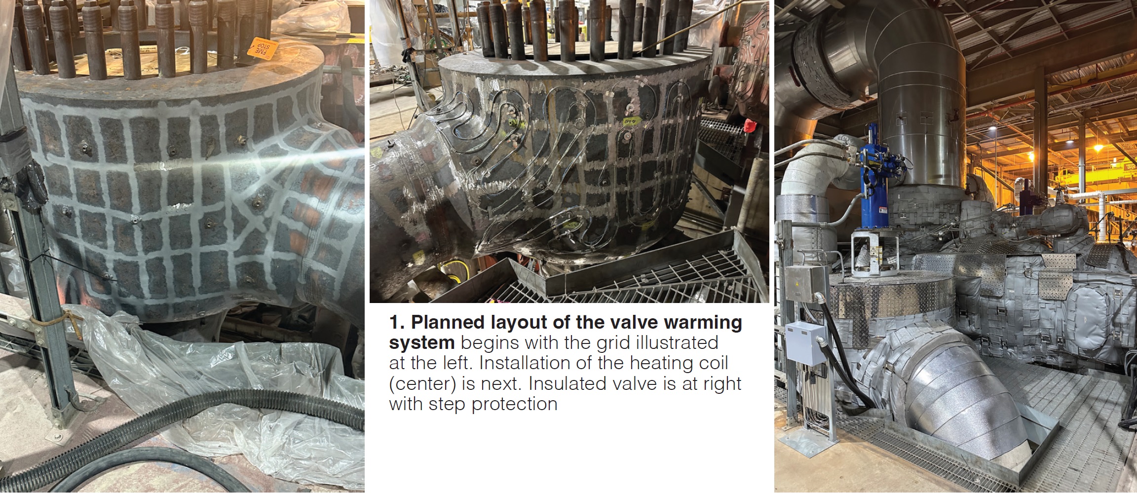

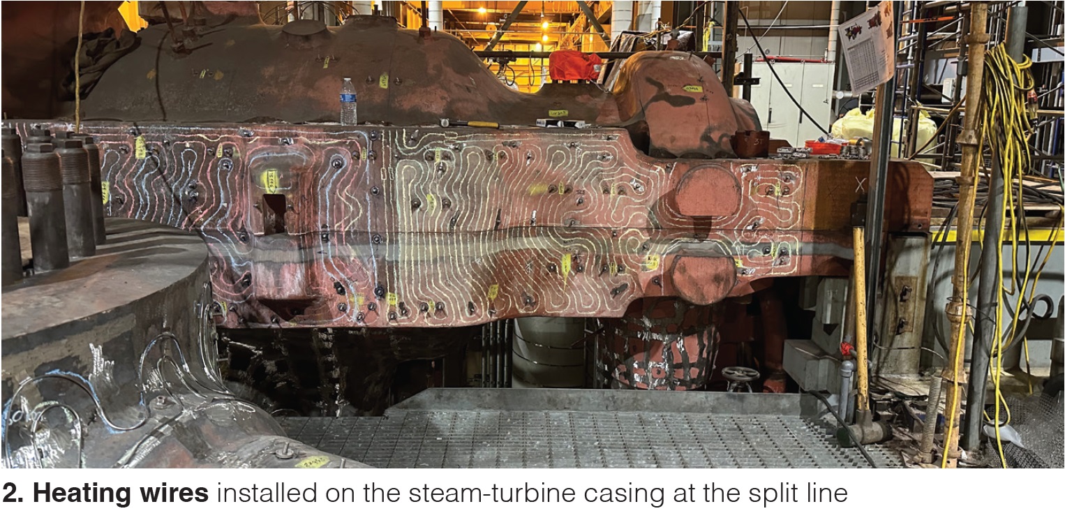

Red Oak was responsible for removing old insulation and pins before the casing was ice-blasted clean. Next, Arnold technicians installed the high-tech warming/insulation system on the main steam valve (Fig 1) and turbine (Fig 2). After post-outage testing of the STG, Red Oak and Arnold personnel commissioned the warming system, which maintained turbine metal temperatures at the optimal level for startup.
