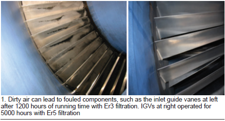

Efficiency. The proportion of particulates entrained in the inlet air and captured by the filter is the most widely recognized performance metric. Because higher-efficiency filters have associated costs, operators need to determine an efficiency rating that delivers the best return on investment (ROI).

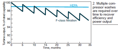

Balancing ratings with cost. Higher filtration efficiency produces cleaner air, which translates into more efficient combustion, sustained power output, and longer-lasting turbines. Dirty air introduces particles that can foul turbine components, decrease compression efficiency, and adversely affect compressor health, as shown in Fig 1.
Compressor water washing can be used to regain power output lost to fouling; however, an overall decrease in efficiency may occur after repeated washings. Fig 2 compares the performance of a GT equipped with a typical F-class filter, after multiple washings, to a similar engine with high-efficiency particulate air (HEPA) filters that did not require online washing.
The downward-sloped lines for the standard filter represent output decreases caused by fouling, followed by upward swings from washing. Note that after multiple washings, output of the engine with a standard F-class filter is less than that of a HEPA filter with no online washing.
A HEPA filter can reduce the need for compressor washing and maintain higher turbine efficiency. This also reduces “soft costs” related to maintenance and equipment downtime. With turbine availability often a key factor in evaluating the financial bottom line, outage costs can be significant.

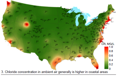

Water-tightness is particularly important in coastal areas, with salt-laden ocean moisture subjecting equipment to accelerated corrosion. Consequently, protection from saltwater represents a key factor affecting the life of gas turbines. OEMs usually recommend that less than 0.01 ppm of salt enter their gas turbines.
In coastal environments, airborne salt can easily range from 0.05 to 0.5 ppm on a typical day. According to data compiled by the National Atmospheric Deposition Program, chloride concentrations in the atmosphere along coastal areas are sometimes more than 10 times the concentrations of inland areas (Fig 3).

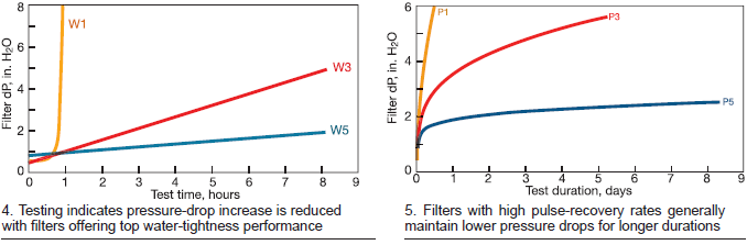

Donaldson developed a new methodology for testing filters in a controlled environment to determine how much, if any, water can pass through a filter. The test directs a 60-liter/hr water spray at the filter over an 8-hr period. The filter pressure drop and volume of water passing through the filter are recorded.
Based on this information, the company rates its gas-turbine filters on a scale of W0 to W5, with higher values indicating greater water-tightness. A filter rated at W0 would not be able to withstand any moisture, while a W5 filter could survive the test with at least 99.5% water stoppage and no more than a 2-in.-H2O increase in pressure drop. Donaldson has tested and rated its most commonly used GT air filters on this scale of water-tightness. Fig 4 shows how higher rated filters reduce the increase in pressure drop over time.

As with efficiency and water-tightness, pulse recovery can be rated using laboratory test data. Donaldson developed a process for measuring this characteristic. Exposing filters to a long duration of simulated sandstorm conditions, filter pressure drop and efficiency are measured to arrive at pulse recovery ratings.

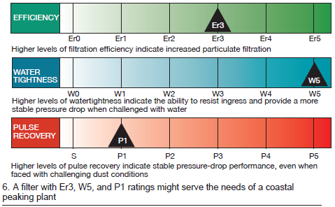

On the Donaldson scale (Fig 6), a static (S) filter cannot be pulse-cleaned without damaging it. The ratings from P1 to P5 in the figure indicate the level of pulse recovery. There are a variety of performance factors with static filters and Donaldson is developing an independent rating system for these applications.

The relationship of recovery rate and pressure drop can be seen in Fig 5. This graph illustrates how long three filters with various pulse-recovery rates maintained acceptable filter pressure drop over time in a simulated dust-challenged environment. Generally, filters with higher recovery rates maintained lower pressure drops for longer durations.

As an example of how efficiency, water-tightness, and pulse recovery should be integrated in filter selection, consider a peaking plant in a coastal environment. Because the plant only operates for short durations, a high-efficiency filter may be difficult to justify economically. The payback for the additional cost of high-efficiency filters would likely be much longer than for that of a continuously running plant.
Because the plant is in a coastal area, water-tightness may be important, but pulse recovery may be less critical if dust exposure is minimal. A filter with Er3, W5, and P1 ratings in efficiency, water-tightness, and pulse recovery, respectively, might serve the needs of such a situation.
