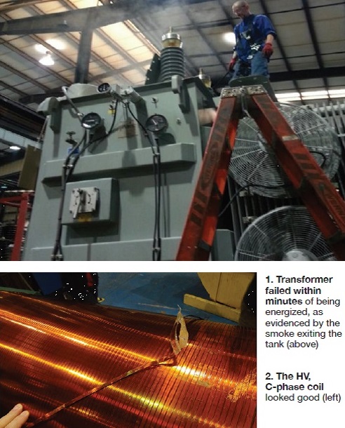

When the transformer arrived at the factory, it was energized at rated voltage with no load. Minutes later the transformer tripped out. When technicians lifted the lid of the access port, smoke poured out: The unit had failed (Fig 1).

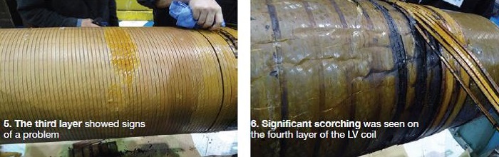

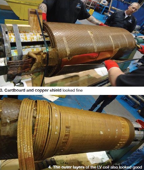

The transformer was disassembled and the C-phase coils were removed for examination. The outside, high-voltage, coil looked fine (Fig 2). Next, the HV coil was unwound to reveal the cardboard and copper shielding between the HV and LV coils. They also looked fine (Fig 3). The outside coils of the LV coil looked good (Fig 4), but as the uncoiling process continued, damage was visible in the third and fourth layers (Figs 5, 6).
Unmistakably, there was a short circuit, coil-to-coil, fault in the low-side C-phase coil. The cause of the fault was never determined. Conclusion: A major outage was averted by carefully testing and monitoring the transformer. This case study also shows the benefits of thoroughly testing a transformer during an investigation. CCJ
