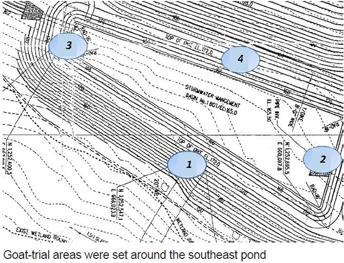

After surveying the southeast pond area, the farmer was willing to locate a small herd of 10 goats in a fenced area for eight weeks. He would visit daily to bring water, check animal health, and oversee progress. This became a trial run to determine whether or not the goats would be comfortable and willing to feed on the overgrowing vegetation. Goats were placed in four different areas of the pond throughout the eight weeks to test their appetites and adjustment to the environment. The results:
Area 1. The southern area of the southeast pond is a steep hill that meets the Conrail Railroad tracks east of the Athens facility. This zone is filled with sumac and had grown into a miniature forest. The view of the tracks (and security perimeter) was obscured by the dense canopy of leaves and thick branches. This area was chosen the first test because of its abundance of sumac.
Within 48 hours, the goats had made significant progress, eating away at the sumac leaves and cleaning their horns on the bark. Within 10 days, and view of the railway was significantly improved. Approximately half of the trees were stripped bare as the goats targeted the staghorn and smooth sumac. They also ate the grass, flowers, and weeds.
The goats concentrated on the steep hill. The untouched vegetation was either plants that they could not ingest, were too high to eat, were poison sumac, or were staghorn containing white flowers (young sumac getting ready to bloom).
Area 2. The goats were moved to the second zone after 10 days. This was the pond area containing cattails and surrounded by sumacs and other vegetation, and was the area of most concern to the facility (pond discharge pipe).
However, because of poor weather and standing water in the pond, the goats did not venture into the base but instead only grazed on the sides, eating the sumac trees.  Their sensitivity to water overruled their preference for cattails, reducing their overall impact. They ate approximately 35% of the area, consuming leaves and breaking down barks, impeding future growth.
Area 3. After 14 days in Area 2, the goats were moved to a zone densely populated with shrubs and weeds on the hill and with staghorn and smooth sumac at the base. This was the smallest test area, bordering a larger natural habitat. Thick vegetation made it difficult to monitor progress. The goats cleaned approximately 25% of the vegetation, primarily on the hill. Rain accumulated on the ground floor where other sumac resided, and the goats were soon moved to the next area.
Area 4. The final test zone was the north region of the southeast pond. This area is also a hill that meets with an adjacent fuel oil tank. It is not filled with cattails but instead consists of tall sumacs, shrubs, bushes, and common weeds. The goats could graze and then rest under the tall trees during hot days.
Approximately 40% of the area was cleared by the feeding. Another 10% was eliminated through sun exposure as the goats stripped the bark and ate the roots. Their preference for sumac reduced any significant impact on other shrubs; they would break the shrub leaves and pull on branches but would not consume them. The farmer became concerned for their nutrition and they only remained for one week.
Results. This trial seemed to benefit the facility, the goats, and the farmer. For the plant, approximately 40% of the overall vegetation in the test pond area was cleared. It was environmentally sound; the vegetation was reduced and nutrients were restored back to the ground. It was also economical, providing a sensible program with positive results. For the farmer, the goats were well fed and grew quickly.
Roadblocks were identifiable. Water in Areas 2 and 3 limited the goat herd’s potential to clear away cattails. Dislike for young, tall staghorn sumac in Areas 1 and 4 limited overall clearing of sumac. But the trial provided first-hand experience and useful data for future trials and programs. Many roadblocks (water accumulation, for example) can be reduced with early planning.
