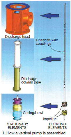

Vertical turbine pumps typically are designed with mixed- or axial-flow impellers and are classified by the Hydraulic Institute as Type VS (vertically suspended). Unlike their horizontal cousins, these pumps include components such as discharge column pipes, lineshaft and support bearings, and the motor mount/discharge head (Fig 1).
Vertical turbine pumps are either partially or fully submerged in the pumpage—below the motor mount. Thus the metallurgy of all pump components must be compatible with the pumped fluid to assure an acceptable mean time between repairs/failure (MTBR/MTBF).

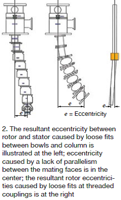

The overriding repair concept for vertical pumps is two-fold: Establish true centerline compatibility between the rotor and stator at the motor-to-discharge head flange location, and ensure that the maximum relative radial displacement of the stator to the rotor—at any point along the entire length of the pump—does not exceed the minimum clearance of the closest running fit.
The goal is to insert the rotating assembly into the stationary components with uniform radial clearance maintained through the pump from the lower bearing to the head stuffing box. This can be achieved only through the application of tight tolerance standards. Fig 2 illustrates what happens when this is not done.

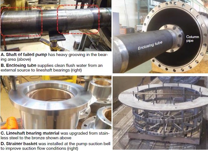

A case for an engineered upgrade
In mid-2012, a customer reported the failure of one of its service-water pumps—a single-stage vertical turbine pump—within six weeks of its re-commissioning after last repair. The pump exhibited high vibration just before failure. Fig A shows the shaft of the failed pump with heavy grooving in the bearing area.
Discussions with the owner/operator revealed that the failed unit was one of four sister pumps operating in parallel, as required. The service life between repairs for each had been only six to 12 months since the pumps were installed. Over time and for the same reasons, the pumps have had significant design changes made by various repair shops.
With this background in hand, HydroAire engineers analyzed the pump design and operational practice with the goal of providing a sustainable solution for allowing the pumps to run longer between overhauls. HydroAire is one of Hydro Inc’s family of pump service companies.
Bearing failure and high vibrations, the major problems identified, were caused by (1) the poor quality of the river water being pumped (it was not clean enough to flush lineshaft bearings), and (2) unfavorable inlet conditions, which impeded pump suction flow. To resolve these issues, HydroAire implemented the following upgrades with the customer’s consent:
  • Installed the enclosing tube with an external clean water source to flush lineshaft bearings (Fig B).
  • Upgraded the lineshaft bearing material from stainless steel to bronze (Fig C).
  • Installed a strainer basket at the pump suction bell for improving suction flow conditions (Fig D).
The repaired/upgraded pump was returned to the plant within a month (emergency basis) and re-commissioned. Today, two years later, the pump still is operating to the customer’s satisfaction. The increase in the mean time between repairs for these pumps was made possible by systematic engineering analysis and the application of proven upgrades.
