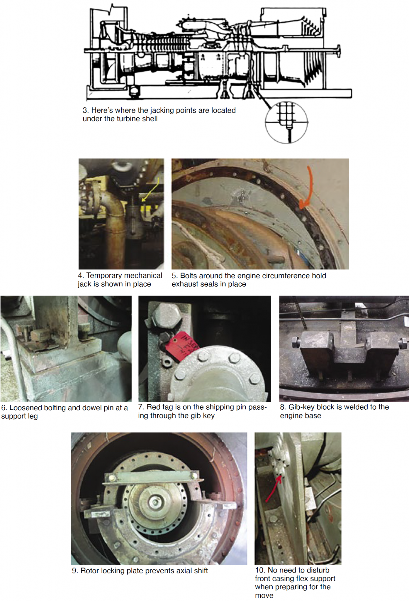

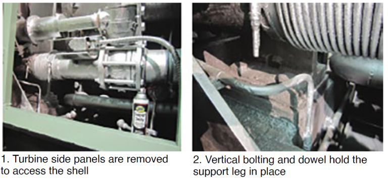

    • Remove the side panels adjacent to the turbine shell (Fig 1), taking note of the two shell supports, bolting, and dowels. Each support foot has four vertical bolts and one dowel (Fig 2).
    • Loosen the bolts for the two support legs shown in Figs 3 and 4 and install mechanical jacks temporarily at each of the two vertical-joint locations. Next, jack up the shell about 15 mils so a shipping pin can be installed in the lower centerline gib key. Shell lifted, tap loose the shims under the support feet, which may be rusted in place. Note that the turbine must “ride” on a shipping pin in case it is “humped” during transport. This can happen when the machine is lifted by crane or transported by truck or train. Damage could occur to the compressor blades and bearings if the unit is not prepared properly.
    • Bolts for the exhaust seal should be loosened, otherwise they may “snap” when the shell is jacked up. The bolts may be rusted, so be prepared to replace them after tapping the holes (Fig 5).
    • Notice the loosened fasteners and elevated dowel pin between the bolts at the left in Fig 6. The dowel remains in place, shims tapped loose, and support legs are not supporting any turbine weight. Fig 7 shows the pin installed to support the turbine shell during shipping to prevent “humping” of the shell. Red tag is to remind personnel that the dowel should be removed after jacking at the new location. Then the legs can be bolted down to support the shell.
    • The horizontal gib key bolts in Fig 8 can remain in place on each side as long as a 25-mil feeler gage can be slipped in to assure the shell (not shown) is not “pinched.” This will maintain the horizontal centerline and shell position. Once they are installed, the mechanical jacks supporting the casing can be removed.
    • Front flex-plate bolting need not be disturbed.
    • The rotor must be pushed axially against the active thrust bearing (located internally on the opposite end at the No. 1 turbine bearing) to keep the rotor secure during shipment. The axial internal clearance between thrust bearings is about 16 to 19 mils. Use a dial indicator (not shown) to “thrust” the rotor backwards against the active thrust bearing (Fig 9).
    • There’s no need to disturb the front compressor flex support when preparing for the move (Fig 10).
